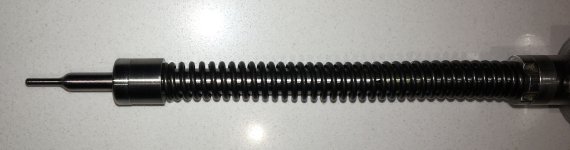

I still have concerns about the ignition system...particularly the lightened firing pin. But as nobody has commented on my light firing pin hypothesis, I'm wondering if I'm barking up the wrong tree.

The screws don't touch the insides of the pillars, the scope base screws don't touch the barrel tenon. Firing pin fall is around .260, with about .030 sear handoff. Firing pin protrusion is .054. Firing spring has not been checked. Rings and bases are torqued to specs. The only thing that I can think of that I haven't done is bed the bases, and lap the rings, both of which I intend to do. I'd be surprised if this was the culprit, though, as I have seen many a rifle (field rifle) shoot well without these steps being done, but you never know. Clearances between bolt and barrel are good. I've checked everything I can think of to check...twice. This rifle is handing me my arse. I miss my longbows...
