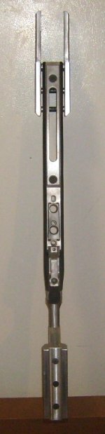

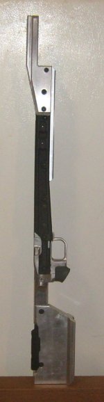

Adding to my creations, but needing more of a special testing platform for the 7BR
solids in the works. I like the MDT's to work on and started with the HS-3's when they
first came out. The Oryx took it's place when the HS-3 was dropped from their lineup.
I happened to have an early model orphan HS-3 in the vault and started making notes.
and changes from earlier works. lots of parts, and a few beers later, I was able to do a
formal mockup......Butt stocks used on the HS-3's used an AR-15 buffer tube so a person
could have a wide range of choices. My choice was to ditch it and replace it with a solid
spine I could mill. A piece of 6061 round stock, thread it, and epoxied in, did the job.
Another chunk of 6061 for the basic stock, then added a 2-1/8" wide bag rider to it.
Stock itself may get more work done to it but only after the rifle is near completion. That
will be a matter of weight and balance......Either way, this is what I have so far on this project,
with a weight at 7 lbs, 4 ounces
