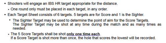

Here would be my argument using the IBS Hunter target. You have 6 targets on a sheet,
5 for scoring and one for sighters. Each "target" is defined for your purpose. The rest of the
sheet is not. My opinion would be that any, shot outside of a defined area would be
considered a fouler/barrel warmer.......
Yes , good argument and seemingly correct. Much better wording from IBS rules than NBRSA (IMHO) but principle same. Targets from both so similar. Would have to conclude this a reasonable answer and certainly have no deduction in score for that oops on the trigger. Hoping it lands outside the squares.
