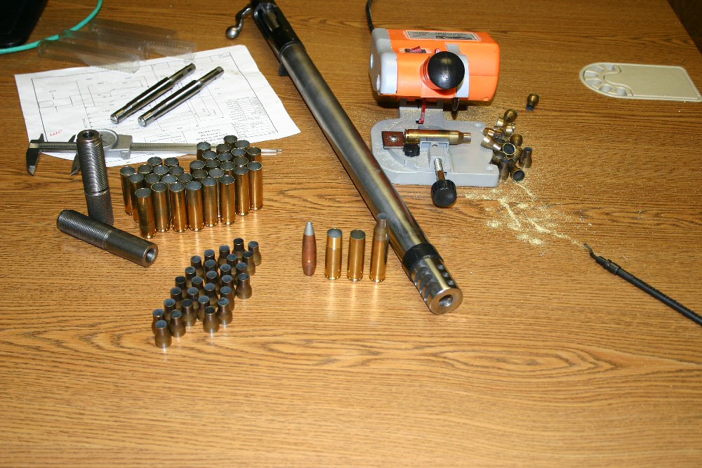

Not sure if this is the best way but I had all the parts and it keep the fingers away from the blade.
I also think that this isn't the best way, though it ensures maximum safety when cutting that should be our primary concern.
