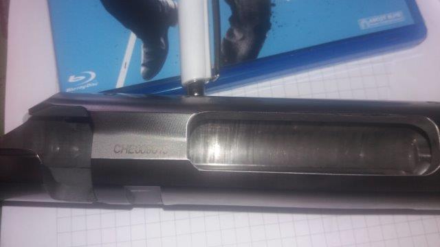

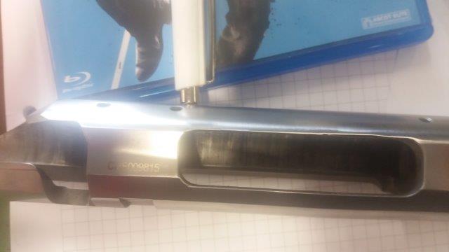

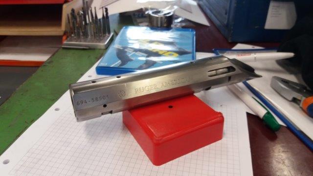

But I wanted to make anyway a custom gun some time, I started thinking about taking this receiver as a basis for my project. I pulled the barrel, and totally disassembled the gun. Just with the bolt and the receiver I went to my company as I have all the dedicated measuring equipment which my home shop lacks. I just wanted to make sure that the receiver is fairly straight to start with. And to my surprise it was totally straight, even with a multi thousand dollar 3d measuring machine it proved to be straight. Then I measured concentricity off the bolt hole, and that was fine too, but the internal finish was horrible, they just bored that hole with a dull boring bar, the surface, I would have made better with a hacksaw… ok here we go…

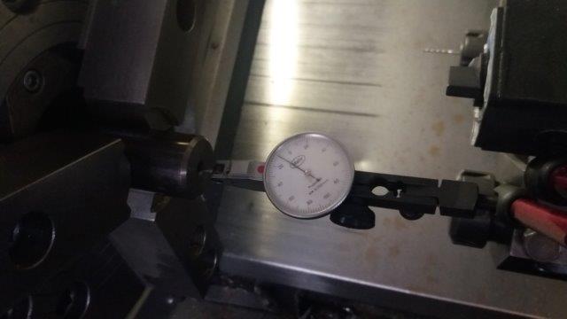

Moved the barrel over to my CNC lathe and dialed in the bore, until I couldn’t measure any runout with my 1 thenthou dialindicator.

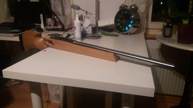

Then when all was finished I wanted to use the origanl stock for the function test, and I hacksawed the sides off the forend away to make room for that fat barrel, but it was so flexy that I screwed that piece off plastic off and threw it in the bin, where such a cheap stock belongs.
I had a salvaged target stock in my basement, from a target airrifle, then I tried to fit that, but the stock wouldn’t fit in any way I would cut and file it…

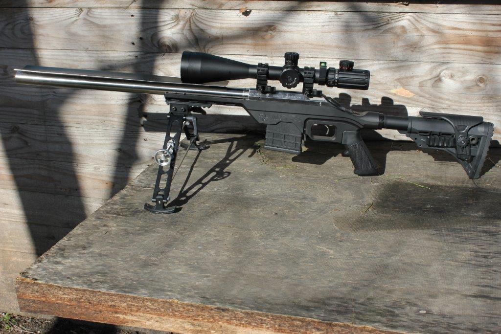

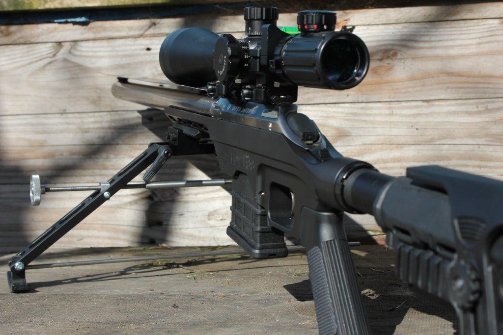

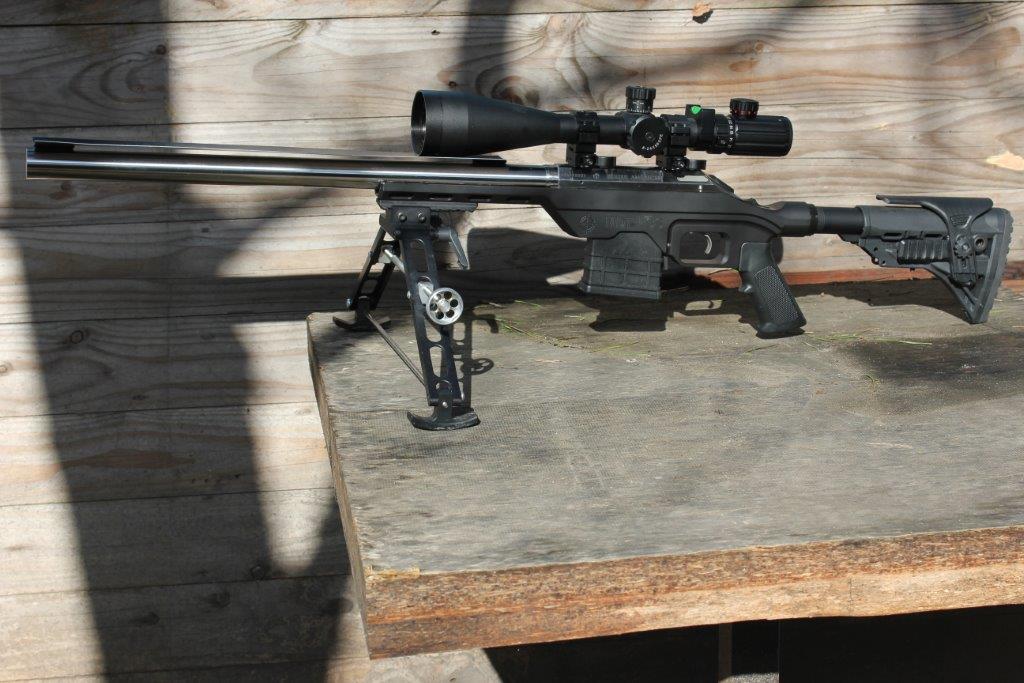

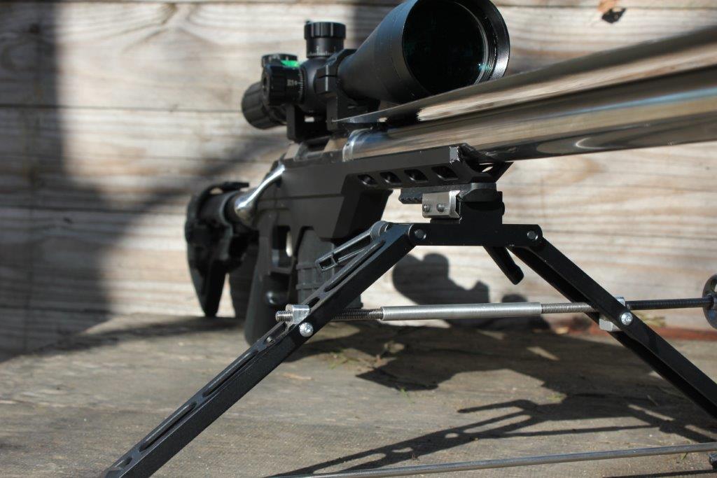

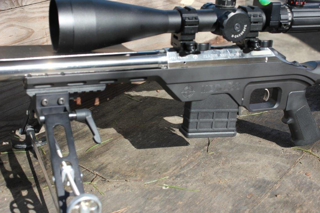

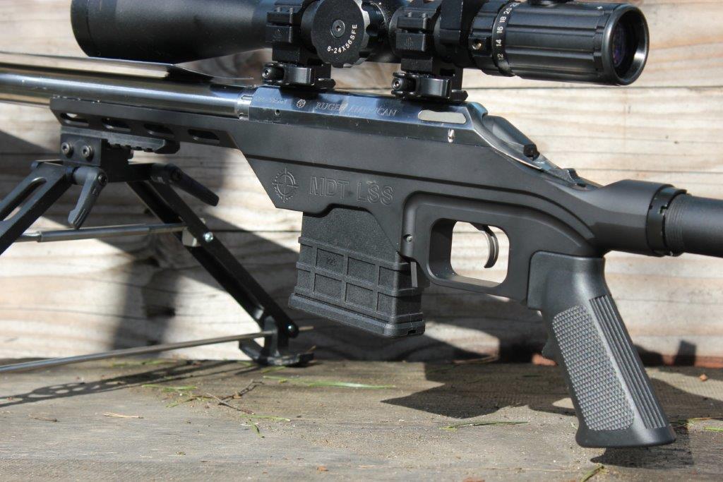

So as time is a little bit off concern, I decided to just buy something I can just screw on. As here in Europe the aftermarket support is quite small for American made rifles. I went for the only option which was stiff and had good bedding right away. The MDT LSS chassis. Which proved to be a good decision.
When that thing came in I bolted it all together, and headed to the range.
Wow, wow wow, no load work up nothing, it just grouped in the .3’s as you can imagine I am a happy camper.

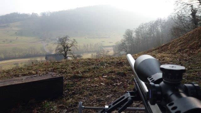

Thank you for your coment! Sierra bullets are my go to bullets, all my guns just love them, they may not have the highest bc in class, but who cares if they have 5% less energy at a given distance, its 5% less waist because you can strike your target at whatever distance you want. One off the pic's above shows a military range where we are aloud to shoot out to 640 meters. And with that gun i can make cold bore hits on a 8x8 inch target. And fire 10 more shots easy on the same target.
